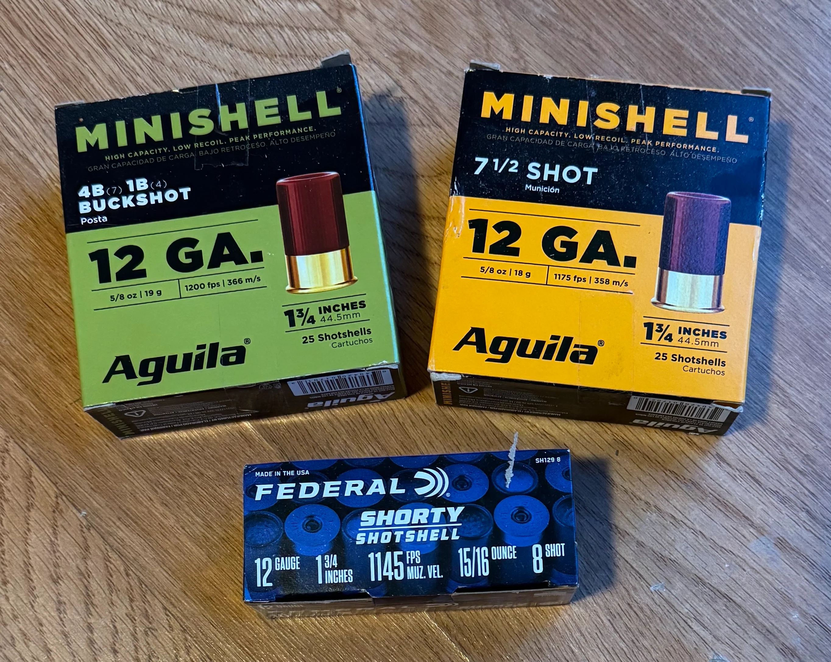

My current HD shottie is a Mossberg Maverick 88 with 20-inch barrel and that same, marvelous Magpul stock where you shorten the length of pull and gain unexpected dividends in speed and maneuverability. Talk about taking a basic pump shotgun to the next level. The other modification I made was to install the ingenious shell adapter from Defender Tactical that allows you to run three sizes of 12-gauge: 3-inch, 2 3/4-inch and the 1 3/4-inch short shells from Federal and Aguila. The short shells give you a lot of performance with a huge reduction in recoil, and my 88 holds 10 in the magazine tube and one in the chamber. They are available in birdshot (my best skeet score ever!) buckshot and slugs and are addictively fun to shoot.
