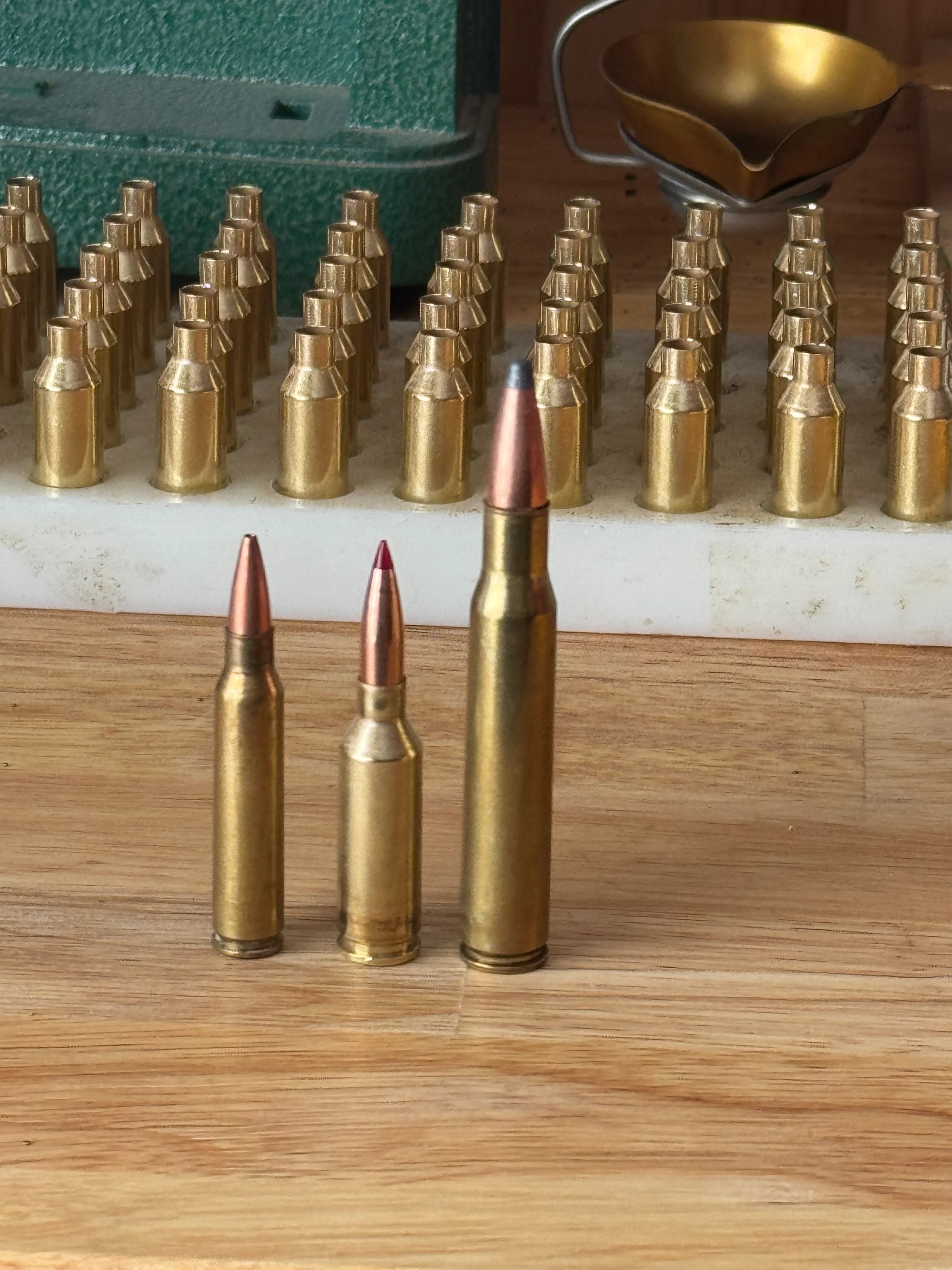

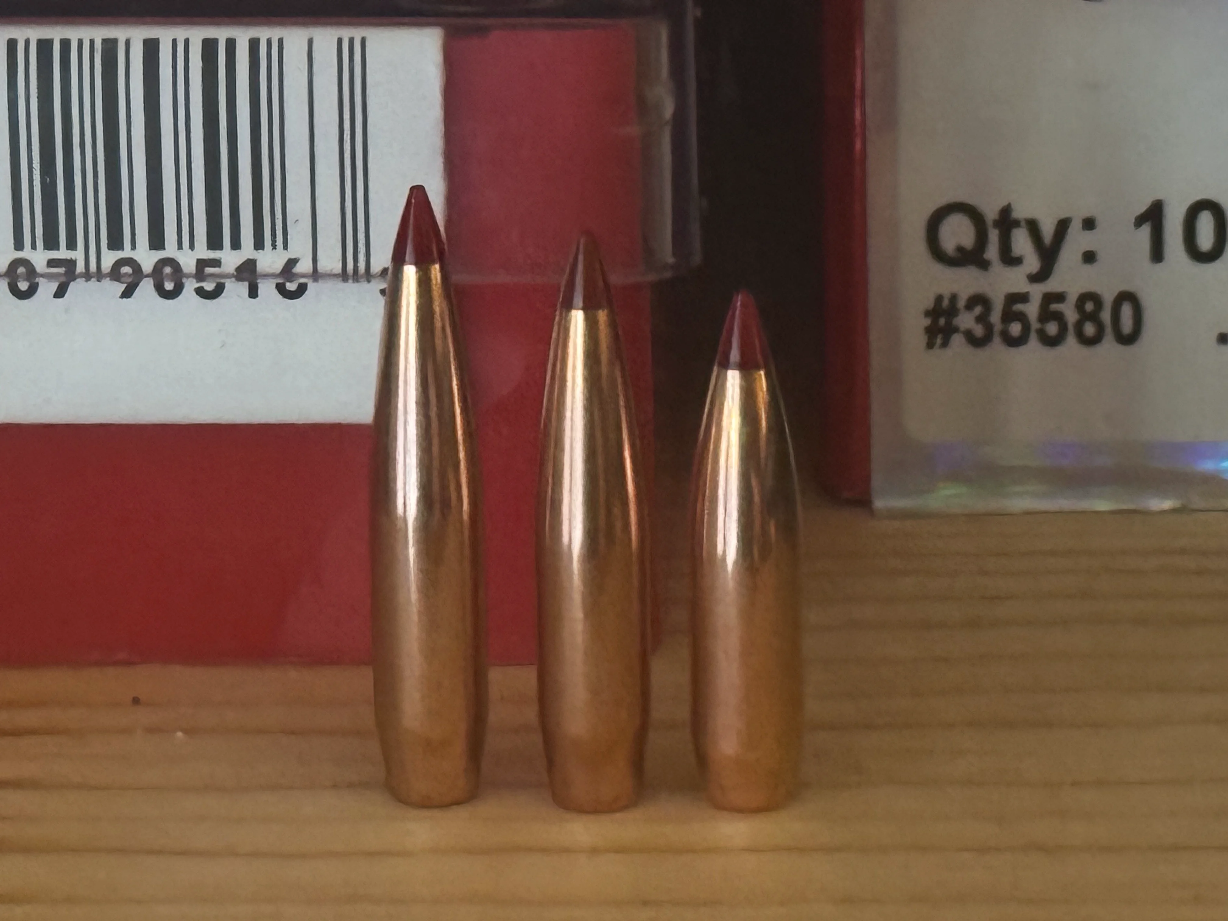

The cartridges, from left, are .223, .22 ARC and .30-06. The bullets, from left, are the Hornady 88-grain ELD-M, 80-grain ELD-M and 73-grain ELD-M.
